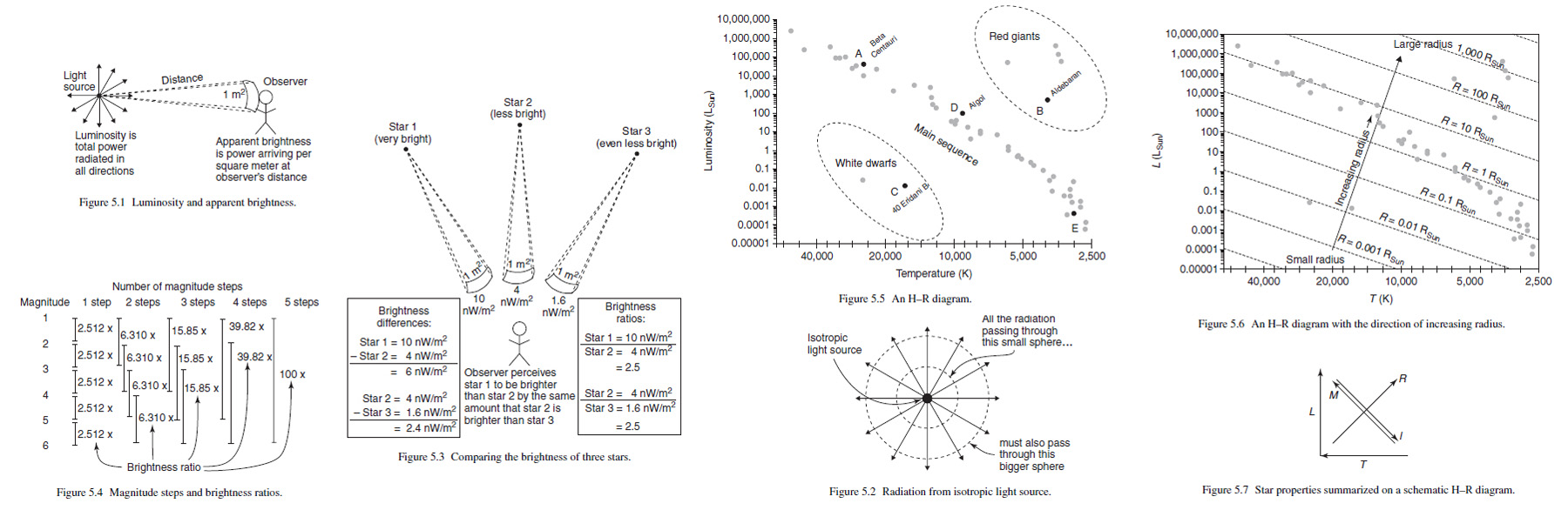

          5.2  Luminosity and apparent brightness
The "luminosity" of an object is defined as the amount of power radiated by an object, with SI units if watts. In contrast the "apparent brightness" of the light source involves both luminosity of the object and the distance between the source and the observer, with SI units of watts per square meter as seen in Figure 5.1. The apparent brightness is a measure not of power, but of received energy flux, which is called "power density" by engineers. The actual received power for any one observer depends on the aperture of the observing system (or the pupils of the observer's eyes).
   For example, if the energy flux at some distance form a light source is 20 microwatts per square meter and our optical system has an aperture area of one-tenth of a square meter, we'll receive one-tenth of 20 microwatts, which is 2 microwatts.
   Experiments have shown that the intensity of radiation varies inversely proportional to the square of the distance. So we have
    (5.4)    apparent brightness ¡ð 1/𝑑𝑖𝑠𝑡2.
   Experiments also reveal that power density is directly proportional to the luminosity of the light source. Thus
    (5.5)    apparent brightness ¡ð 𝐿.
   Combining the proportionality relationships of Eqs. t,4 and 5.5 gives
    (5.6)    apparent brightness ¡ð 𝐿/𝑑𝑖𝑠𝑡2     or
    (5.7)    apparent brightness = const ⨯ (𝐿/𝑑𝑖𝑠𝑡2).
   The case of a light source that radiates equal power in all directions: such a source is called "isotropic." The radiation from an isotropic light source is shown in Figure 5.2. In this figure, the dashed circles represent two imaginary spheres surrounding the isotropic light source, and the arrows represent radiation emanating from the source in all directions (three-dimensionally) outward. Because the total power (the number of watts) hitting both spheres must be the same. Since energy flux is defined as the power per unit area, the apparent brightness of the source for an observer at the inner sphere is
    (5.8)    (apparent brightness)inner = 𝐿/𝑆𝐴𝑖𝑛𝑛𝑒𝑟 𝑠𝑝𝘩𝑒𝑟𝑒.
where 𝑆𝐴 = the surface area. Since the source area of a sphere is 4¥ð times the radius (𝑅) of the sphere squared, this is
    (5.9)    (apparent brightness)inner = 𝐿/4𝜋(𝑅𝑖𝑛𝑛𝑒𝑟)2.
   Likewise, for an observer at the outer sphere, the apparent brightness is
   (5.10)    (apparent brightness)outer = 𝐿/4𝜋(𝑅𝑜𝑢𝑡𝑒𝑟)2.
   So both Eqs. 5.9 and Eqs. 5.10 can be written more generally as
   (5.11)    apparent brightness = 𝐿/4𝜋(𝑑𝑖𝑠𝑡)2.

          5.3  Magnitudes
In addition it the quantities of apparent brightness and luminosity, astronomers have another system of classifying the brightness of celestial objects. That system is called the "magnitude" system, and it's based on the way the human eye sees different intensities of light. We'll explain the two main types of magnitude. "Apparent magnitude" is related to the apparent brightness of a light source. "Absolute magnitude" is related to the intrinsic brightness, or luminosity of the source.
   The apparent magnitude scale was introduced over 2,000 years ago by the Greek astronomer Hipparchus, who grouped the stars into six categories. He lumped the 20 or so brightest stars into the category called "first magnitude", slightly dimmer but bright stars into "second category, Medium-brightness stars into "third magnitude", dim stars into "fourth magnitude", very dim stars "fifth magnitude" and barely visible stars into "sixth magnitude".The apparent magnitude of a celestial object often denoted as "𝑚." Hipparchus's first-magnitude group comprises constellations such as Orion or the Southern Cross, most of the stars in Big Dipper would belong to the second-magnitude group and the Little Dipper would span from second to fourth or fifth magnitude. In today's light-polluted skies, the sixth-magnitude category are invisible from all but the very best observing sites.
   When scientists began to make quantitative measurements of the brightness of light source, they discovered an interesting fact: the apparent magnitude operate in a logarithmic fashion rather than linear one. In Figure 5.3 when we are looking at three stars in Hipparchus's first-magnitude, second-magnitude and the third-magnitude, measurement reveal that in fact 𝑚 = 2 star are about 2.5 times dimmer than 𝑚 = 1 star, and  𝑚 = 3 star are about 2.5 times dimmer than 𝑚 = 2 star. So the ratio of brightness categories is constant but the difference is not.
   In the 19th century, British astronomer Norman Robert Pogson suggested that five steps in magnitude should correspond exactly to factor of 100 in brightness. Thus the brightness ration corresponding to one magnitude step should be 3¡î100 = 2.512. Fig. 5.4 illustrates the relationship between magnitude steps and brightness ratios. So we have an equation like this:
   (5.12)    brightness ratio = (2.512)# mag steps,
where "# mag steps" (𝛥𝑚) represents the number of magnitude steps between the two object.
   For example, the apparent magnitude of Altar in the constellation of Aquila is 𝑚 = 0.77, and Merak in the Big Dipper is 𝑚 = 2.36, then the brightness ration is
            brightness ratio = (2.512)(2.36 - 0.77) = (2.512)1.59 = 4.325,
   so Altair is a little over four times brighter than Merak.

          5.4  H-R diagram
The Hertzsprung-Russel (H-R) diagram is a graph of two properties luminosity and temperature of many stars. Many dots on an H-R diagram represent stars, which remain fixed for the vast majority of their lives. For most stars, that location falls on abroad swath running from the upper left to the lower right portions of the star diagram; this is called the "main sequence," and it encompasses most of stars plotted in Figure 5.5. The few stars that are not on the main sequence generally occupy regions in either the upper right, called "red giants", or lower left, called "white dwarfs."
   The two star properties on the H-R diagram are luminosity (𝐿) and  (surface) temperature (𝑇). However, there are three other stellar properties- star radius (𝑅), lifetime (𝓵), and mass (𝑀). Because H-R diagram represents all five of these fundamental stellar properties in one compact graphs, it is such a powerful tool in astronomy.
In order to express physical quantities more intuitively, astronomers employ a set of "solarcentric" units that use our Sun's properties as a reference. The subscript ¢Á is frequently used to indicate a parameter  pertains to the Sun, so "M¢Á" means "MSun". The three most-common solarcentric units are solar luminosities ("L¢Á" or "LSun"), solar radii ("R¢Á" or "RSun"), and solar mass ("M¢Á" or "MSun"). Here are the equivalence relations for them:
     1 M¢Á (solar mass) ⟷ 2 ⨯ 1030 kg,
     1 L¢Á (solar luminosity) ⟷ 4 ⨯ 1026 W,
     1 R¢Á (solar radius) ⟷ 6.96 ⨯ 105 km.
   (MEarth ⟷ 6.0 ⨯ 1024 kg ≈ 3.0 ⨯ 10-6 M¢Á or M¢Á = 3.3 ⨯ 106 MEarth, and  REarth ⟷ 6.37 ⨯ 103 kg ≈ 1.09 ⨯ 10-2 M¢Á or R¢Á ≈ 109 ⨯ REarth.)
   It is instructive to show relationship among star's radius, luminosity and surface temperature:
   (5.19)    𝑅2 ¡ð 𝐿/𝑇4.
   For example, if we rank the labeled stars in Figure 5.5 in order of increasing size, we can have Figure 5.6.
   So the ranking of all five from smallest to largest id C < E < D < A < B.

   We may sketch a bare-bones H-R diagram with arrows indicating the the direction in which each of parameters increases. Figure 5.7 shows arrows indicating the direction of all five properties of stars discussed in this section.
