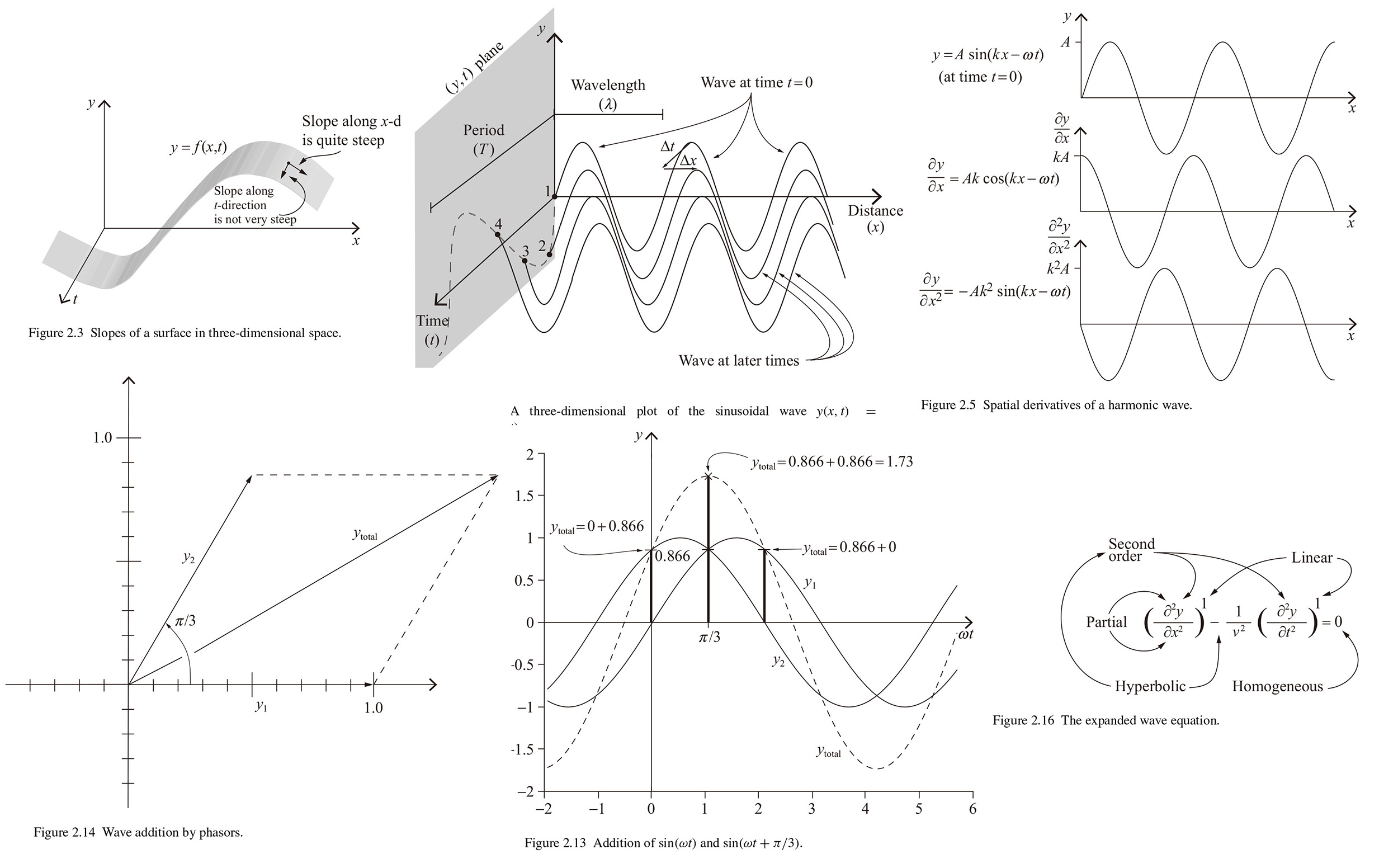

 2 The wave equation
          2.1 Partial derivatives
We use ordinary deriatives to find the slope of a line (𝑚 = 𝑑𝑦/𝑑𝑥) or to determine the speed of an object given its position as a function of time (𝑣𝑥 = 𝑑𝑥/𝑑𝑡). But because wavefunctions (𝑦) generally depend on two or more variables, such as distance (𝑥) and time (𝑡): 𝑦 = 𝑓(𝑥, 𝑡), we must use partial derivatives which are written as ∂/∂𝑥 or ∂/∂𝑡.
   Notice that at the location shown in Fig. 2.3 the slope of the surface is quite steep in the direction of increasing 𝑥 (while remaining at the same value of 𝑡), but the slope is almost zero if you move in the direction of increasing 𝑡 (while holding our 𝑥-value constant). We can see how this works in the following example.
Example 2.1 For the function 𝑦(𝑥, 𝑡) = 3𝑥2 - 5𝑡, find the partial derivative of 𝑦 with respect to 𝑥 and with respect to 𝑡.
      ∂𝑦/∂𝑥 = ∂(3𝑥2 - 5𝑡)/∂𝑥 = ∂(3𝑥2)/∂𝑥 - ∂(5𝑡)/∂𝑥 = 3∂(𝑥2)/∂𝑥 - 0 = 6𝑥.
      ∂𝑦/∂𝑡 = ∂(3𝑥2 - 5𝑡)/∂𝑡 = ∂(3𝑥2)/∂𝑡 - ∂(5𝑡)/∂𝑡 = 0 - 5∂𝑡/∂𝑡 = -5.
We can take higher-order partial derivatives. So for example
      ∂/∂𝑥 (∂𝑦/∂𝑥) = ∂2𝑦/∂𝑥2     ∂/∂𝑡 (∂𝑦/∂𝑡) = ∂2𝑦/∂𝑡2.
For example, consider the wave function 𝑦(𝑥, 𝑡) = 𝐴 sin(𝑘𝑥 - 𝜔𝑡) plotted in Fig. 2.4. In this plot, we can see the behavior of 𝑦 over distance and the behavior of 𝑦 over time. And the first partial derivative of 𝑦 with respect to 𝑥 is
    (2.1)   ∂𝑦/∂𝑥 = ∂[𝐴 sin(𝑘𝑥 - 𝜔𝑡)]/∂𝑥 = 𝐴 ∂[sin(𝑘𝑥 - 𝜔𝑡)]/∂𝑥 = 𝐴 cos(𝑘𝑥 - 𝜔𝑡) ∂(𝑘𝑥 - 𝜔𝑡)/∂𝑥 = 𝐴 cos(𝑘𝑥 - 𝜔𝑡) [∂(𝑘𝑥)/∂𝑥 - (𝜔𝑡)/∂𝑥] = 𝐴 cos(𝑘𝑥 - 𝜔𝑡) [𝑘∂𝑥/∂𝑥 - 0]     or      ∂(𝜔𝑡)/∂𝑥 = 𝐴𝑘 cos(𝑘𝑥 - 𝜔𝑡).
The second partial derivative of 𝑦 with respect to 𝑥 is
    (2.2)   ∂2𝑦/∂𝑥2 = ∂[𝐴𝑘 cos(𝑘𝑥 - 𝜔𝑡)]/∂𝑥 = 𝐴𝑘 ∂[cos(𝑘𝑥 - 𝜔𝑡)]/∂𝑥 = -𝐴𝑘 sin(𝑘𝑥 - 𝜔𝑡) ∂[(𝑘𝑥 - 𝜔𝑡)]/∂𝑥 = -𝐴 sin(𝑘𝑥 - 𝜔𝑡) [𝑘∂(𝑘𝑥)/∂𝑥 - (𝜔𝑡)/∂𝑥] = -𝐴𝑘 sin(𝑘𝑥 - 𝜔𝑡) [𝑘 ∂𝑥/∂𝑥 - 0]     or      ∂2𝑦/∂𝑥2 = -𝐴𝑘2 sin(𝑘𝑥 - 𝜔𝑡).
   Plots of the wavefunction and its first and second partial derivatives with respect to 𝑥 at time 𝑡 = 0 are shown in Fig. 2.5. If we are wondering how the cosine shape of the first partial derivatives of 𝑦(𝑥, 𝑡) relates to the shape of the wavefunction. And turning now to the behavior of this function over time, the first partial derivative of 𝑦 with respect to 𝑡 is
    (2.3)   ∂𝑦/∂𝑥 = ∂[𝐴 sin(𝑘𝑥 - 𝜔𝑡)]/∂𝑡 = 𝐴 ∂[sin(𝑘𝑥 - 𝜔𝑡)]/∂𝑡 = 𝐴 cos(𝑘𝑥 - 𝜔𝑡) ∂(𝑘𝑥 - 𝜔𝑡)/∂𝑡 = 𝐴 cos(𝑘𝑥 - 𝜔𝑡) [∂(𝑘𝑥)/∂𝑡 - (𝜔𝑡)/∂𝑡] = 𝐴 cos(𝑘𝑥 - 𝜔𝑡) [0 - 𝜔 ∂𝑡/∂𝑡]     or      ∂𝑦/∂𝑡 = -𝐴𝜔 cos(𝑘𝑥 - 𝜔𝑡).
The second partial derivative of 𝑦 with respect to 𝑡 is
    (2.4)   ∂2𝑦/∂𝑡2 = ∂[-𝐴𝜔 cos(𝑘𝑥 - 𝜔𝑡)]/∂𝑡 = -𝐴𝜔 ∂[cos(𝑘𝑥 - 𝜔𝑡)]/∂𝑡 = 𝐴𝜔 sin(𝑘𝑥 - 𝜔𝑡) ∂(𝑘𝑥 - 𝜔𝑡)/∂𝑡 = 𝐴𝜔 sin(𝑘𝑥 - 𝜔𝑡) [∂(𝑘𝑥)/∂𝑡 - (𝜔𝑡)/∂𝑡] = 𝐴𝜔 sin(𝑘𝑥 - 𝜔𝑡) [0 - 𝜔 ∂𝑡/∂𝑡]     or      ∂2𝑦/∂𝑡2 = -𝐴𝜔2 sin(𝑘𝑥 - 𝜔𝑡).

Example 2.2 Consider two sine waves with following wavefunctions:
            𝑦1(𝑥, 𝑡) = 𝐴1 sin(𝑘1𝑥 + 𝜔1𝑡 + 𝜖1),
            𝑦2(𝑥, 𝑡) = 𝐴2 sin(𝑘2𝑥 + 𝜔2𝑡 + 𝜖2).
If 𝐴1 = 𝐴2 = 1, 𝑘1 = 𝑘2 = 1, 𝜔1 = 𝜔2 = 2 rad/s, but 𝜖1 = 0 and 𝜖2 = π/3, determine the characteristics of the wave that results from the addition of these waves.
    (2.21)   𝑦1(𝑥, 𝑡) = 𝐴1sin(𝑘1𝑥 + 𝜔1𝑡 + 𝜖1) = sin(𝑥 + 2𝑡 + 0),
            𝑦2(𝑥, 𝑡) = 𝐴2sin(𝑘2𝑥 + 𝜔2𝑡 + 𝜖2) = sin(𝑥 + 2𝑡 + π/3),
    (2.22)   𝑦total(𝑥, 𝑡) = sin(𝑥 + 2𝑡) + sin(𝑥 + 2𝑡 + π/3),
    (2.23)   sin(𝜃1 + 𝜃2) = 2 sin[(𝜃1 + 𝜃2)/2]cos[(𝜃1 - 𝜃2)/2].
and plugging in 𝜃1 = 𝑥 + 2𝑡 and 𝜃2 = 𝑥 + 2𝑡 + π/3 gives
    (2.24)   𝑦total(𝑥, 𝑡) = 2 sin[(2𝑥 + 4𝑡 + π/3)/2]cos[-(π/3)/2].
where 𝐴 = 2cos(-π/6) ≈ 1.73, and 𝑥 = 0, they look like Fig. 2.13.
   Another very powerful way to analyze the superposition of waves is through the use of phasors. As shown in Fig. 2.14 for the location 𝑥 = 0 at time 𝑡 = 0, these example can be represented bu a rotating phasors. So we have
            𝑦1(0, 0) = 𝐴1sin(𝑘1𝑥 + 𝜔1𝑡 + 𝜖1) = (1)sin(1(0) + 2(0) + 0) = 0,
            𝑦2(𝑥, 𝑡) = 𝐴2sin(𝑘2𝑥 + 𝜔2𝑡 + 𝜖2) = (1)sin((1)(0) + 2(0) + π/3) ≈ 0.866.
  If we prefer to use the "addition of components" approach to finding the resultant phasor 𝑦total, we can use the geometry of Fig. 2.14. Thus the magnitude and phase angle of 𝑦total are
    (2.25-26)   𝐴total = √(1.52 + 0.8662) = 1.73,     𝜖total= tan-1 (0.866/1.5) = π/6.
