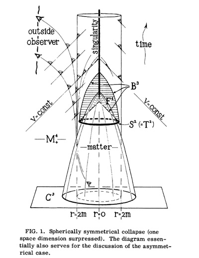

  Before examining the asymmetrical case, consider a spherically symmetrical matter distribution of finite radius in 𝐶3 which collapses symmetrically. The empty region surrounding the matter will, in this case, be a Schwarzschild field, and we can conveniently use the metric 𝑑𝑠2 = -2𝑑𝑟𝑑𝜐 + 𝑑𝜐2(I - 2𝑚/𝑟) - 𝑟2(𝑑𝜃2 + sin2𝜃𝑑𝜑2), with an advanced time parameter 𝜐 to describe it.8 The situation is depicted In Fig. 1. Note that an exterior observer will always see matter outside 𝑟 = 2𝑚, the collapse through 𝑟 = 2𝑚 to the singularity at 𝑟 = 0 being invisible to him.
  After the matter has contracted within 𝑟 = 2𝑚, a spacelike sphere 𝑆2 (𝑡 = const, 2𝑚 > 𝑟 = cosnt) can be found in the empty region surrounding the matter. This sphere is an example of what will be called here a trapped surface−defined generally as a closed, spacelike, two-surface 𝛵2 with the property that the two systems of null geodesics which meet 𝛵2 orthogonally converge locally in future directions at 𝛵2. Clearly trapped surface will still exist if the matter region has no sharp boundary or if spherical symmetry is dropped, provided that the derivations from the above situation are not too great. Indeed, the Kerr solutions with 𝑚 > 𝑎 (angular momentum 𝑚𝑎) all possess trapped surfaces, whereas those for which 𝑚 ≤ 𝑎 do not.9 The argument will be to show that the existence of a trapped surface implies−irrespective of symmetry−that singularities necessarily develop.
  The existence of a singularity can never be inferred, however, without an assumption such as completeness for the manifold under consideration. It will be necessary, here, to suppose that the manifold 𝛭+4, which is the future time development of an initial Cauchy hypersurface 𝐶3 (past boundary of the 𝛭+4 region), is in fact null complete into the future.. The various assumptions are, more precisely, as follows: (i) 𝛭+4 is a nonsingular (+---) Riemannian manifold for which the null half-cones form two separate systems ("past" and "future"). (ii) Every null geodesic in 𝛭+4 can be extended into the future to arbitrarily large affine parameter values (null completeness). (iii) Every timelike or null geodesic in 𝛭+4 can be extended into the past until it meets 𝐶3 (Cauchy hypersurface condition). (iv) At every point of 𝛭+4, all timelike vectors 𝑡𝜇 satisfy (-𝑅𝜇𝜈 + ½𝑅𝑔𝜇𝜈 - 𝜆𝑔𝜇𝜈) 𝑡𝜇𝑡𝜈 ≥ 0 (non-negativeness of local energy). (v) There exists a trapped surface 𝛵2 in 𝛭+4. It will be shown here, in outline, that (i), ⋅⋅⋅, (v) are together inconsistent.
  Let 𝐹4 be the set of points in 𝛭+4 which can be connected to 𝛵2 by a smooth timelike curve leading into the future from 𝛵2. Let 𝐵3 be the boundary of 𝐹4. Local considerations show that 𝐵3 is null where it is nonsingular, being generated by the null geodesic segments which meet 𝛵2 orthogonally at a past endpoint and have a future endpoint if this is a singularity (on a caustic or crossing region) of 𝐵3. Let 𝑙𝜇 (subject to 𝑙𝜇;𝜈𝑙𝜈 = 0), 𝜌 (=-½𝑙𝜇;𝜇), and ∣𝜎∣ {=[½𝑙(𝜇;𝜈)𝑙𝜇;𝜈 - ¼(𝑙𝜇;𝜇)2]½} be, respectively, a future-pointing tangent vector, the convergence, and the shear for these null geodesics,10 and let 𝐴 be a corresponding infinitesimal area of cross section of 𝐵3. Then [(𝐴½);𝜇𝑙𝜇];𝜈𝑙𝜈= -(𝐴½𝜌);𝜇𝑙𝜇=-𝐴½(∣𝜎∣2 + 𝛷) ≤ 0 where 𝛷 = -½𝑅𝜇𝜈𝑙𝜇𝑙𝜈 [≥0 by (iv)]. Since 𝛵2 is trapped, 𝜌 > 0 at 𝛵2, whence 𝐴 becomes zero at a finite affine distance to the future of 𝛵2 on each null geodesic. Each geodesic thus encounters a caustic. Hence 𝐵3 is compact (closed), being generated by a compact system of finite segments. We may approximate 𝐵3 arbitrarily closely by a smooth, closed, spacelike hypersurface 𝐵3✶. Let 𝐾4 denote the set of pairs (𝑃, 𝑠) with 𝑃 ⋲ 𝐵3✶ and 0 ≤ 𝑠 ≤ 1. Define a continuous map 𝜇: 𝐾4 → 𝛭+4 where, for fixed 𝑃, 𝜇{(𝑃, 𝑠)} is the past geodesic segment normal to 𝐵3✶ at 𝑃 = 𝜇{(𝑃, 1)} and meeting 𝐶3 [as it must, by (iii)] in the point 𝜇{(𝑃, 0)}. At each point 𝑄 of 𝜇{𝐾4}, we can define the degree 𝑑(𝑄) of 𝜇 to be the number of points of 𝐾4 which map to 𝑄 (correctly counted). Over any region not containing the image of a boundary point of 𝐾4, 𝑑(𝑄) will be constant. Near 𝐵3✶, 𝜇 is 1-1, so 𝑑(𝑄) =1. It follows that 𝑑(𝑄) =1 near 𝐶3 also, whence the degree of the map 𝐵3✶ → 𝐶3 induced by 𝜇 when 𝑠 = 0 must also be unity. The impossibility of this follows from the noncompactness of 𝐶3.
