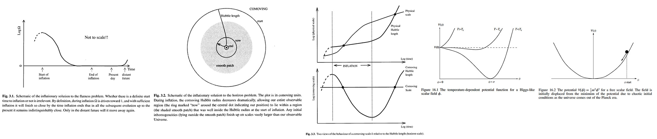

    Fig. 3.1-3 from Andrew L. Liddle and David H. Lyth Cosmological inflation and Large-Scale Structure (Cambridge University Press 2000)
