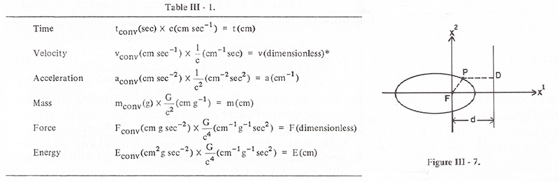

4. The Universal Law of Gravitation Ø¿êóìÚÕôÀÇ ÛööÎ <- Table III-1 ÂüÁ¶

        F = GMm/r2  <- F: magnitude of force, M and m: masses, r: distance of centers, G: gravitational constant ñìÕôßÈ⦠  [4-106]
        Á߷»ó¼ö G´Â Àç·¡½Ä(conventional) cgs ´ÜÀ§°è(centimeter, grams, seconds)·Î´Â ¾à 6.67 X 10-8 cm3/(g sec2) ÀÔ´Ï´Ù.
      ∘ Áö±ÝºÎÅÍ Chapter II ¿¡¼­ ±¤¼ÓÀ» ±æÀÌ(cm)·Î ȯ»êÇϵí, ¹«°Ô(g)µµ ±æÀÌ(cm)·Î ¹Ù²Ù´Â geometric units À» »ç¿ëÇÕ´Ï´Ù. [Table III-1 ÂüÁ¶]
        gram to cm conversion factor : G/c2 ≈ 7.425 X 10-29 cm/g  <- ±¤¼Ó c ≈ 2.9979  X 1010 cm/sec
        ¿¹¸¦ µé¸é ´ÞÀÇ Áú·® M¢Á = MconvG/c2 ≈ (1.99 X 1033 g)(7.425 X 10-29 cm/g) ≈ 1.48 X 105 cm  <- conv: coventional unit
        Fconv = GMconvmconv /r2  becomes  F = Mm /r2 in geometric units .
5. Orbits in Newton's Theory <- Figure III-7 ÂüÁ¶
      ∘ NewtonÀÇ ¸¸À¯ÀηÂÀÇ ¹ýÄ¢À¸·Î KeplerÀÇ ¹ýÄ¢À» À¯µµÇÕ´Ï´Ù. ±¸´ëĪÀÎ ¹°Ã¼´Â Áß·ÂÀûÀ¸·Î´Â "Á¡ Áú·®"ó·³ ÀÛ¿ëÇÑ´Ù°í ÇÏ¿´À¸¹Ç·Î
        𝐗(t) = (x1(t), x2(t), x3(t)): Ç༺ÀÇ À§Ä¡, r: žç°ú Ç༺ÀÇ Á߽ɰ£ °Å¸®,  M and m: žç°ú Ç༺ÀÇ °¢°¢ÀÇ Áú·®ÀÌ µË´Ï´Ù.[Figure III-7]
        ¾ö°ÝÇϰԴ Å¾ç°ú Ç༺Àº °øÀ¯ÇÑ Áß·ÂÀÇ Áß½ÉÀÇ ÁÖÀ§¸¦ °øÀüÇÏ´Â °ÍÀÌÁö¸¸, žçÀÇ Áú·®ÀÌ Ç༺ÀÇ ¸î¹è°¡ µÇ¹Ç·Î °¡±î¿î ±Ù»ç°ªÀ¸·Î,
        žçÀÌ Á÷±³ ÁÂÇ¥°èÀÇ ¿øÁ¡¿¡ °íÁ¤µÈ °ÍÀ¸·Î °£ÁÖÇÒ ¼ö ÀÖ½À´Ï´Ù.
        𝐎 = 𝐗 ⨯ 𝐗" = (𝐗 ⨯ 𝐗")  + (𝐗' ⨯ 𝐗')  = d (𝐗 ⨯ 𝐗') /dt,   𝐀 = 𝐗 ⨯ 𝐗', 𝐗 ∙ 𝐀  =  𝐗 ∙ (𝐗 ⨯ 𝐗') = 𝐗' ∙ (𝐗 ⨯ 𝐗) = 0
      ∘ Ç༺Àº Á÷±³ ÁÂÇ¥°è¿¡¼­ x1°ú x2ÃàÀÌ Çü¼ºÇÏ´Â Æò¸é¿¡¼­ ¿òÁ÷ÀÔ´Ï´Ù. r, 𝜃 ´Â x1 = r cos 𝜃, x2 = r sin 𝜃 ÀÎ, ÇØ´çÇÏ´Â ±ØÁÂÇ¥°èÀÔ´Ï´Ù.
        °¢°¢ unit vectorÀÎ radial vector 𝐮r°ú  transvers vector 𝐮𝜃¸¦ 𝐮r = (cos 𝜃, sin 𝜃 ),  𝐮𝜃 = (-sin 𝜃, cos 𝜃 )·Î Á¤ÀÇÇÕ´Ï´Ù.
        d𝐮r/d𝜃 = 𝐮𝜃,  d𝐮𝜃/d𝜃 = - d𝐮r; ±×·¯¸é 𝐗(t) = r𝐮r,
        𝐗'(t) = dr/dt 𝐮r + r d𝜃/dt  𝐮𝜃  <-  by product rule   [5-107]
        𝐗"(t) = [d2r/dt2 - r(d𝜃/dt)2]𝐮r + [r (d2𝜃/dt2) + 2 (dr/dt)(d𝜃/dt)] 𝐮𝜃   [5-108]
        r2 d𝜃/dt = h (constant)  <- r (d2𝜃/dt2) + 2 (dr/dt)(d𝜃/dt) = 1/r( d/dt (r2 d𝜃/dt)) = 0   [5-109]
        𝐅 = Mm/r2𝐮r,  𝐗" =  - M/r2𝐮r,  - M/r2= d2r/dt2 - r(d𝜃/dt)2,  - (r2/h2) (d2r/d2) + 1/r) = M/r2   [5-110,111,112,113]
        ÆíÀÇ»ó new variable u = 1/rÀ» µµÀÔÇÕ´Ï´Ù.  du/d𝜃 = - (1/r2) (dr/d𝜃) =  - (1/r2){ (dr/dt )/(d𝜃/dt)} = - (1/h) (dr/dt),
                                                                    d2u/d𝜃2 = - (1/h) d/dt { (dr/dt) / (d𝜃/dt)} = - (r2/h2) (d2r/dt2)
        d2u/d𝜃2 + u = M/h2  -> »ó¼ö ÇÔ¼ö u = M/h2´Â ÀÚ¸íÇÑ ÇØÁß ÇϳªÀÓ.   [5-114]
        d2u/d𝜃2 + u = 0  -> the general soluntion: u = k1cos 𝜃 + k2sin 𝜃.**,  cos(x - y) = cos x cos y + sin x siny   [5-115]
        ±×·¯¹Ç·Î u = (1/d) cos (𝜃 - 𝜃0) + M/h2µµ ÇϳªÀÇ ÇØ°¡ µÉ¼ö ÀÖÀ¸¸ç, ¶ÇÇÑ ¸¸ÀÏ d>0, 𝜃0 = 0 À̶ó¸é ´ÙÀ½ÀÇ ¹æÁ¤½ÄÀÌ µË´Ï´Ù.
        u = M/h2 (1 + e cos 𝜃)  <- e = h2/(Md),  ed = r(1 + e cos 𝜃) or r = e(d - r cos 𝜃) <- if e<1, it is an ellipse   [5-116,117,118]
        Cartesian ÁÂÇ¥°è·Î º¯È¯Çϸé, (x + c)2/a2 + y2/b2 = 1,  a= ed/(1 - e2), b = a(1- e2)1/2,  c = ae   [5-119]
        Å¸¿øÀÇ ¸éÀû 𝐀 = 𝜋ab = 𝜋a2(1- e2)1/2,  d𝐀/dt = h/2, a: semi-major axis(±ä¹ÝÁö¸§), b: semi-minor axis(ªÀº¹ÝÁö¸§)
        Ç༺ÀÇ ÁÖ±â 𝐓 = 2𝐀/h = 2𝜋a2(1- e2)1/2/h, 𝐓 = (2𝜋a2/h)(h/(Ma)1/2 = 2𝜋/M1/2 a3/2 [Kepler's Third Law: 𝐓2 ¡ð (2a)3]  ▮
