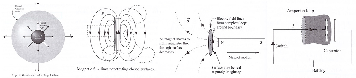

1) Gauss's law for electrical fields: ¢±s 𝑬 ∙ ň da = q /𝜖₀  [ň: unit normal vector, 𝑬: electric field in volts V/m, q: charge, 𝜖₀: permittivity of free space(Áø°ø À¯ÀüÀ²)]
    * Electric charge produces an electric field, and the flux of that field passing through any closed surface is proportional to the total charge contained within that surface.
       applying the divergence theorem ->    𝛁 ∙ 𝑬 = 𝜌/𝜖₀  [𝜌: charge density(ÀüÇÏ ¹Ðµµ) coulombs C/m©ø]
    * The electric field produced by electric charge diverges from positive charge and converges upon negative charge.
2) Gauss's law for magnetic fields: ¢±s 𝑩 ∙ ň da = 0 [𝑩: magnetic field in tesla T]
    * The total magnetic flux passing through any closed surface is zero.
       applying the divergence theorem ->    𝛁 ∙ 𝑩 = 0
    * The divergence of the magnetic field at any point is zero.
3) Faraday's law: ¢±c 𝑬 ∙ d𝒍 = - d/dt (¡òs 𝑩 ∙ ň da) = - ¡òs (¡Ó𝑩/¡Ót) ∙ ň da  <- emf: electromotive force(À¯µµ±âÀü·Â)
    * Changing magnetic flux through a surface induces an emf in any boundary path of that surface, and a changing magnetic field induces a circulating electric field.
       applying Stoke's theorem ->    𝛁 ¡¿ 𝑬 = - ¡Ó𝑩/¡Ót
    * A circulating electric field is produced by a magnetic field that changes with time.
4) Ampere-Maxwell law: ¢±c 𝑩 ∙ d𝒍 = 𝜇₀ [𝑱 + 𝜖₀ d/dt (¡òs 𝑬 ∙ ň da)] [𝜇₀: magnetic permittivity of free space(Áø°ø ÅõÀÚÀ²),  𝑱: electric current in amperes A] <- ¥ì(mu)
    * An electric current or a changing electric flux through a surface produce a circulating magnetic field around any path that bounds that surface.
       applying Stokes' theorem ->    𝛁 ¡¿ 𝑩 = 𝜇₀ (𝑱 + 𝜖₀ ¡Ó𝑬/¡Ót) [𝑱: current density(Àü·ù ¹Ðµµ) A/m©÷]
    * A circulating magnetic field is produced by an electric current and by an electric field that changes with time.
