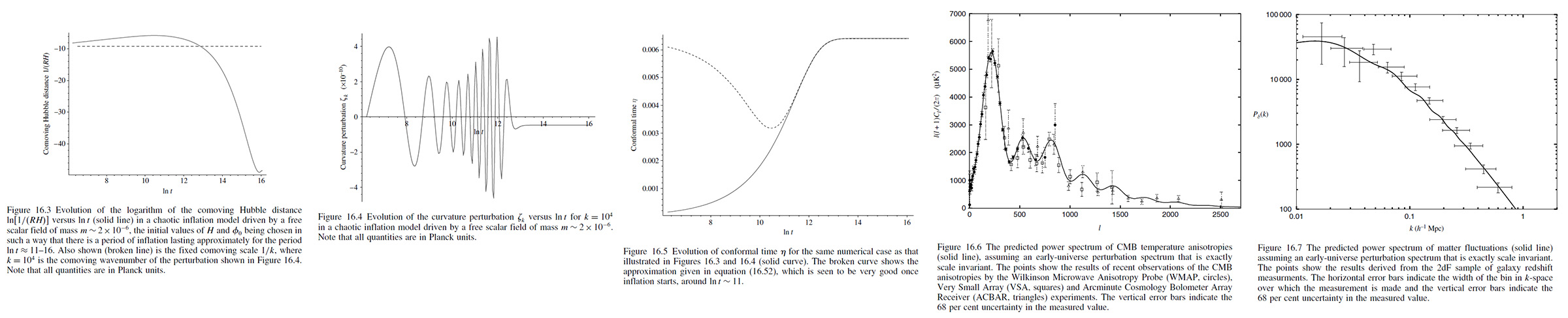

Given a potential 𝑉(ⱷ0) and some initial conditions for 𝛨 and ⱷ0, we can integrate the background evolution equations numerically and obtain 𝛨 and 𝜔0 as functions of cosmic time 𝑡. If we simultaneously integrate 𝛇𝑘 using (16.45), we can thereby trace the evolution of the curvature perturbation over the time period of interest. An example of the results of this procedure is shown in Figure 16.3 and 16.4, for 𝑉(ⱷ0)  = 1/2 𝑚202 (chaotic inflation) with 𝑚 ~ 2 ⨯ 10-6 (a typical value in such theories). The period ln 𝑡 ≈ 11-16 for the inflation and the comoving wavenumber of the perturbation was chosen as 𝑘 = 104.
   From Figure 16.3, one can see the universe is inflating during that period, since comoving Hubble distance 1/(𝑅𝛨), which is called the 'horizon' in inflationary theory, is decreasing. The broken line in From Figure 16.3 is the natural logarithm of the reciprocal of the comoving wavenumber 𝑘, which is of course constant for a given perturbation.. This reciprocal, 1/𝑘, can be thought of as the comoving wavelength scale of the perturbation itself.
   The behavior of the curvature perturbation 𝛇𝑘 is shown in Figure 16.4 for 𝑘 = 104 and can be understood from the behavior of the'horizon' or
the comoving Hubble distance in Figure 16.3. Whilst the perturbation scale 1/𝑘 is less than the horizon radius 1/(𝑅𝛨) the curvature perturbation 𝛇𝑘 just oscillates. Once 1/(𝑅𝛨) has dropped below 1/𝑘, we see that the perturbation suddenly 'freeze' and no longer oscillates. We speak of this moment as the perturbation ;leaving the horizon' and in intuitive terms, we can understand that beyond this point the perturbation is no longer able to feel its own self-gravity, since it is larger than the characteristic scale over which physical process in the universe operate coherently. If much later in history of the universe when the horizon catches up with 1/𝑘 again, the perturbation is said to 're-enter the horizon' and oscillations will begin again. (though it is not expected that there will be the scalar field itself, since it is though to decay into other particles via the process of reheating, shortly after inflation ends.
   The key point to note is that, via inflation, one has produced 'super-horizon' scale fluctuation in the early universe. These fluctuations later go on to provide the seeds for galaxy formation and the perturbation in the cosmic background (CMB) radiation that we observe today. By studying the distribution of galaxies and CMB fluctuation as a function of scale, it is possible to obtain an idea of the underlying primordial spectrum of perturbation that produced them. Thus, by predicting this primordial spectrum spectrum, we can perform a test of the whole inflationary picture for the origin of fluctuation. We can give only a simplified treatment , but the basic equations are within our reach, we now discuss.

Since we know that 𝛇𝑘 is constant after the mode has left the horizon, this means we are free to evaluate the right-hand side at the horizon exit itself. We therefore write schematically
    (16.57)    𝛇𝑘 ≈ 𝑖/¡î(2𝑘3) (𝛨2/ᾠ0)∣𝑘=𝑅𝛨
This is a famous and important result in inflationary theory; it gives the (constant) value  of the amplitude of the plane-wave curvature perturbation having comoving wavenumber 𝑘 for modes whose length scale exceeds the horizon.

    (16.63)    𝓟(𝑘) = (𝑘/2¥ð𝑅)2𝑘=𝑅𝐻 = (𝐻/2¥ð)2.
We have evaluated the second expression at the 'horizon crossing' value of 𝑘, 𝑅𝐻, since fluctuations on larger length scales are 'frozen in' at the value they reached at this point. To translate this result into the power spectrum of curvature perturbation 𝓡, we need to link 𝓡 and 𝛿ⱷ. Consider 𝛥𝑡 would be needed to move from the 'comoving slicing', in which 𝛿ⱷ vanishes, to a 'flat slicing', in which 𝚽 vanishes. Since 𝛇, as defined in (16.39), remain constant in this process, we see that, in this case,
    (16.64)    𝛥𝚽 = 𝚽 = -𝓡 = 𝐻𝛥𝑡     and     𝛥ⱷ = 𝛿ⱷ = -ᾠ0𝛥𝑡,
Eliminating 𝛥𝑡 we find that 𝓡 = 𝐻𝛿ⱷ/ᾠ0 and hence we recover the result, (omitting the detailed process¡Ø)
    (16.60)    𝓟𝓡(𝑘) = 𝓟𝛇(𝑘) = [𝐻2/(2¥ðᾠ0)]2𝑘=𝑅𝐻

             𝛿𝑘(𝑡) ¡ð 𝑡2/3     (matter-dominated),
which provides a quick derivation of the time dependence of what is known as  the growing mode of the matter-density perturbations.
          16.19 Comparison of theory and observation   .
Here we are going to see two brief illustrations. Figure 16.6 shows the predition for the power spectrum of anisotropies in the cosmic microwave backgroubd (CMB) radiation, assuming That the early-universe perturbation spectrum is scale invariant.The anisotropies in the temperature of the CMB radiation provide a 'snapshot' of the (projected) density perturbations at epoch of recombination (𝑧rec ≈ 1500). The CMB anisotropies over the sky are usually decomposed of spherical harmonics as
           𝛥𝑇(𝜃, 𝜙) = ¢²¡Ä𝑙=2 ¢²𝑙𝑚=-𝑙 𝑎𝑙𝑚𝑌𝑙𝑚(𝜃, 𝜙),
where the 𝑙 = 0 (constant) and 𝑙 = 1 (dipole) terms are usually ignored, since the former is unrelated to the anisotropies and the latter is due to the pecular velosity of the Earth with respect to the comoving frame of the CMB.The power in the fluctuations as a function of angular scale is therefore characterised by the spectrum
           𝐶𝑙 = 1/(2𝑙 + 1) ¢²𝑙𝑚=-𝑙 ∣𝑎𝑙𝑚2.
The characteristic peaks in the predicted CMB power spectrum (solid line) are a consequence of another feature of inflation that all modes outside the horizon are frozen and can only start to oscillate once they re-enter the horizon later in the universe's evolution. This means that a 'phasing up' is able to occure, in which all modes of interest start from effectively a 'zero velocity' state they begin the oscillations during the epoch of recommbination, that lead to the CMB imprints.This is what enables peak to be visible in the power spectrum, with modes on different scales able to complete a different number of oscillations before the end of recommbination. Coherence, leading  to peaks, is maintained since each mode has the same starting conditions.This is only possible if the modes of interest are indeed on super-horizon scales prior to recombination, and the only known way of achieving this is via inflation. Thus the peaks visible in Figure 16.6 are a powerful means of testing for inflation. The points shown in the figure are the results of recent observations by the WMAP (circle), VSA (square) and ACBAR (triangles) experiments, which yields a very impressive confirmation of the peak structure and thereby a direct confirmation that inflation occurred.
   The primordial matter power spectrum 𝑃𝛿(𝑘) in (16.67) is modified by the evolution under gravity of the perturbations once they re-enter the horizon. This effect may be calculated and the predicted matter power spectrum is shown as the solid line in Figure 16.7. Once again we see that the predicted spectrum has oscillations resulting from a mechanism analogous to that of the CMB discussed above. The points in the figure show the measurements derived from the 2dF (2 degree field) sample of galaxy redshift measurements. Again, a good fit to the data is visible, and time will tell whether the detailed dynamics of inflation, which can be measured by the departures from scale invariance, will become accessible from the combination of data of this type and future CMB experiments.
