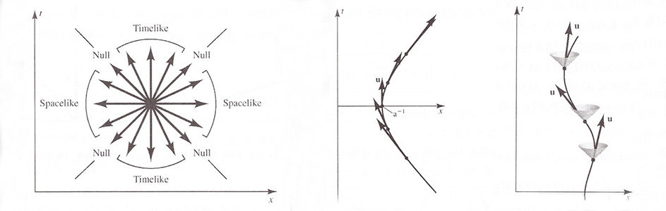

5.1  4º¤ÅÍ(Four-Vectors)
4-º¤ÅÍ(four-vectors)¶õ 4Â÷¿ø ½Ã°ø°£ º¤ÅÍÀÌ¸ç ±×¸²Ã³·³ ½Ã°£²Ã(timelike), °ø°£²Ã(spacelike), ³Î(null) 4-º¤ÅͰ¡ ÀÖÀ¸¸ç, ³Î 4-º¤ÅÍ´Â ºñÀ¯Å¬¸®µå ±âÇÏ¿¡¼­ ±æÀ̰¡ 0ÀÔ´Ï´Ù.
¾ÕÀ¸·Î °£È¤ ±×³É º¤ÅÍ(vector)¶ó°í ÇÒ ¶§¿¡µµ º¸Åë 4-º¤ÅÍ(four-vectors)¸¦, ±âÀúº¤ÅÍ(basis vectors)´Â ±âÀú 4-º¤ÅÍ(basis four-vectors)¸¦ °¡¸£Å°´Â °ÍÀ¸·Î °£ÁÖÇϽñ⠹ٶø´Ï´Ù.

5.2  Æ¯¼ö»ó´ë¼º ¿îµ¿ÇÐ(Special Relativistic Kinematics)
À§ µÎ¹øÂ° ±×¸²Àº ´Ü¼øÈ÷ °¡¼ÓµÈ(simple accelerated)ÀÇ ¼¼°è¼±ÀÇ ¿¹·Î¼­ °íÀ¯½Ã°£ 𝜏·Î¼­ ¸Å°³º¯¼öÀûÀ¸·Î Ç¥½ÃµÈ ¼¼°è¼±À» º¸¿©ÁÝ´Ï´Ù. [È­»ìÇ¥ 𝐮´Â ¾Æ·¡ÀÇ 4-velocity)]
        x¥á = x¥á(¥ó)  <- 𝜏: °íÀ¯½Ã°£(proper time)   <5-21>
        t(¥ò) = a-1sinh(¥ò),   x(¥ò) = a-1cosh(¥ò)   <5-22>
        d¥ó2 = -ds2 = dt2 - dx©÷ = [a-1cosh(¥ò)d¥ò]2 - [a-1sinh(¥ò)d¥ò]2 = (a-1d¥ò)2   <5-23>   <- cosh2(¥ò) - sinh2(¥ò) = 1
        t(¥ó) = a-1sinh(a¥ó),   x(¥ó) = a-1cosh(a¥ó)   <5-24>
À§ ¼¼¹øÂ° ±×¸²Àº ¾Õ¿¡¼­ ¸»ÇÑ ÀÔÀÚÀÇ ¼¼°è¼±(particle's worldline)ÀÇ °î¼±¿¡¼­ µÎ¹øÂ° ±×¸²¿¡¼­¿Í ¸¶Âù°¡Áö·Î Á¢¼±º¤ÅÍ(tangent vector 𝐮¸¦ º¸¿©ÁÖ°í ÀÖ½À´Ï´Ù.
        u¥á = dx¥á /d𝜏   <5-25>   <-  𝐮: 4-velocity)
